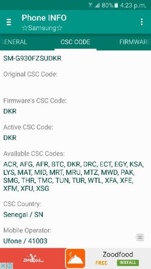

Install Phone INFO ★Samsung★, free from the Play Store and post your phone's Product Code. This dictates which firmware and updates, if any, you receive.

1. You have not posted your Product Code
2. Your warranty for repairs will be void if you flash any firmware other than the one that matches your Product Code.

I just did. I uploaded two images above.

According to your screenshot, above, your Product code, SM-G930FZSUDKR is NOT for the dual sim model, G930FD, but for the single sim Global model, G930F, for Senegal, Africa???
According to your screenshot, above, your Product code, SM-G930FZSUDKR is NOT for the dual sim model, G900FD, but for the single sim Global model, G930F, for Senegal, Africa???

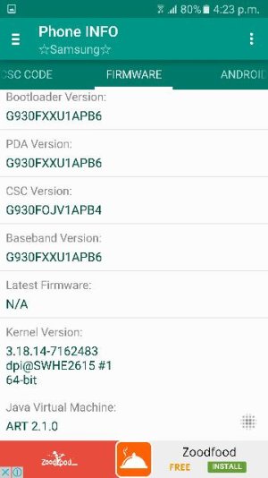

Can you just tell me if there's any way I can find out which version of 6.0.1 this phone is running? Is there a way to know?
Edit: think I found it. It's the build date right? It shows 6th February on my phone. And the firmware link you sent has links with build dates of April. So I can flash one of those via odin? And everything will be fine?
I can find no stock Samsung firmware for Product Code DKR, Senegal, Africa, in the samsung files. The fact that your original CSC Code is also not showing, leads me to believe that either...
1. Your phone is rooted and running a custom ROM
2. It has had a, "cloneware", (modified firmware), flashed to it.

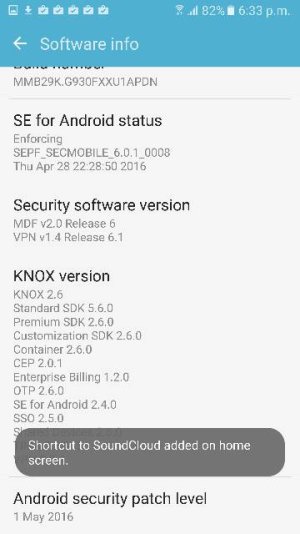

I downloaded a 930F firmware and flashed my phone with odin.
I didn't lose dual sim functionality.
I didn't void any warranty.
My phone works perfectly.
I am on the latest firmware released just a few days ago.
With the May security patch.
And May build date.
