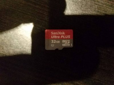

Ok I removed the SD and everything worked fine. I can't find the class but I know I made sure it was at least 80mb/sec or whatever that's supposed to say on the package of the SD. It only has 210 pictures on it so I wouldn't think that's too many. Here's a picture of my SD.20161128_072055.jpg
The SD card could be corrupt, defective, or counterfeit. Install SD Insight to see if the card is genuine or counterfeit. Counterfeit cards are programmed to report more storage than they actually have, and if you try saving more than the card can actually hold, then files can start getting corrupt.
If it's a valid card, then go to Settings>Storage, Unmount the card, remove it, and insert it into your computer. Can the computer read these files? Backup as much as you can right now, then run chkdsk to look for bad sectors: http://forums.androidcentral.com/am...guide-using-chkdsk-fix-corrupted-sd-card.html. If it finds bad sectors, and the photos aren't crucial to save, then go ahead and allow chkdsk to try repairing those sectors.

Counterfeit cards are more of a problem if you buy them from random sellers on places like eBay or the Amazon Marketplace (i.e., not directly from Amazon). Stick with well-established stores.
SanDisk is definitely one of the better brands out there, but even SanDisk cards can become corrupted. If you're using 3rd party camera apps, perhaps there's a glitch in their code that's causing the corruption. But keep in mind that SD cards in general use relatively low quality memory chips, in comparison with onboard memory chips (according to an acquaintance of mine who's an engineer in that field). My recommendation is to use any SD card with caution, and to backup or sync that data on a regular basis to your computer or the cloud.
