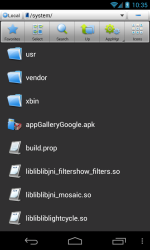

I have attached an image of the files that seem to appear at the end of my system folder , is that normal?
Thanks man, I couldn't figure out what was wrong but your zip file fixed it, thanks 100x
