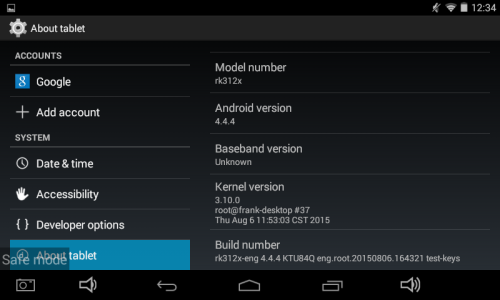

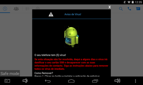

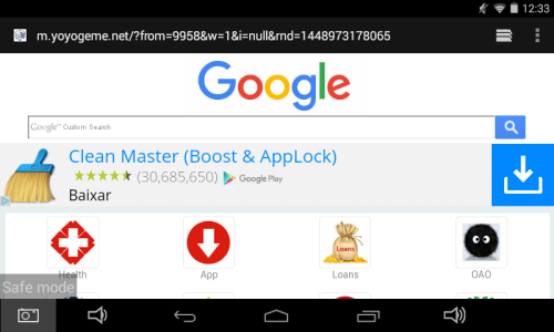

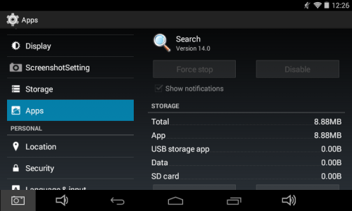

Tried booting in Safe Mode, and I still got the ads. The search app I am referring to is just called "Search" and came installed in the device (including after factory reset). I have included it in the screenshots below, and took one of the "about tablet" version of the Settings. (I didn't buy the tablet myself, so I don't know the model)
The app Addons Detector only marks Search as problematic, which sucks because it's not one I can remove. As I said before, all of the few apps I got were from the google store, and not exactly obscure (messenger, youtube, vlc, etc).
Do you need more information to help? Should I reset, or is it not really gonna solve my problem?
Thank you!

It looks like you have some kind of off-brand or no-name tablet, so it's very difficult to determine if that "Search" app was preinstalled by the manufacturer or inadvertently installed by you as a piece of malware. If the latter is the case, then the app was installed to the system's root, which is going to be virtually impossible to get rid of unless you can re-flash the firmware. If the former is the case, then you're still stuck with it, even if you re-flash the stock firmware.
Does the tablet come with the Google Search app preinstalled? Look through Settings>Apps>All for "Google app." If there's no Google Search app, then it's more plausible that this Search app was preinstalled by the manufacturer--it may be that the tablet isn't certified for Google Play, and therefore isn't compatible with most Google apps.

After viewing the images, it seems to be a OCU model 759 rockchip tablet. Can u pls turn over the tablet and check out for the model. If it's same as i m thinking kindly let me know.
And can u tell that the advrtismnt problem on the tablet is from the date u have purchased it or it is a issue after some days.

Hey, sorry for the great delay. It is indeed marked 759 in the back. Does that help?
It starts a week or two after every reset I do - the Search app I referred is automatically installed.

Hope this link helps. If u knw how to upgrade or downgrade firmware. First of all u have to find which rockchip tablet it is. http://www.rockchip.nl/downloads/
