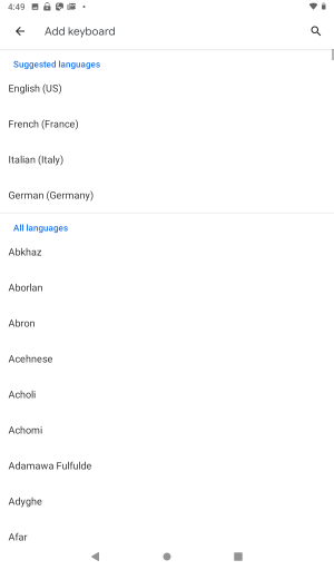

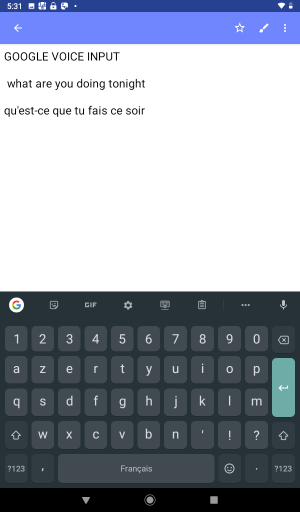

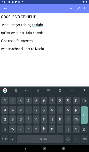

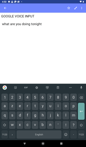

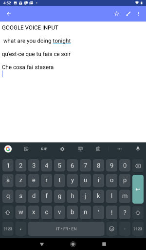

Hacker's keyboard definitely does the trick on Android 9 at least.
