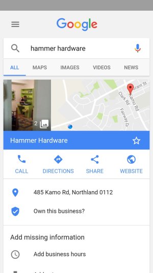

Another interesting part to my problem is with the Call function after searching businesses. See attached screen shot.
This is a search of the local hardware store and normally I can select the Call function and the phone app will open and the number loaded for calling. This stopped working as well and nothing will happen when selecting. BUT, if I uninstall the updates and it runs the older version and do another search for the hardware store and then select the Call function IT WORKS. It gets better, if I install the Google Updates and try it again it STILL WORKS. BUT at some stage as time goes on and I try this function it will not work. So something changes somewhere at some time and virtually impossible to what and when. In the mean time no change to the "Call Mum" scenario during all this, still "No phone app installed".
