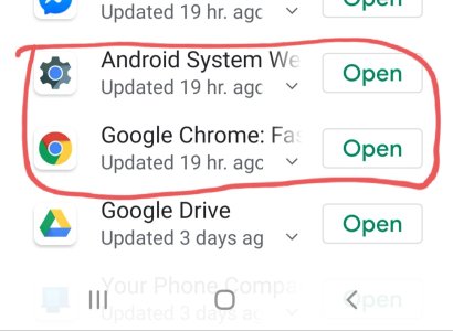

Guys .. I had the same problem few days ago ..
Turned out it was google server over load ..
Be patient .. run update time to time it will go through .

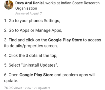

SUCCESS! After trying a bunch of different things, what worked was uninstalling updates of Play Store itself/reverting it to the stock version - as described in the post at the link below (I likely also cleared Play Store data/cache).
Try rolling back your Play Store App. It may have recently been updated and causing your problem. I had the same problem until I rolled back Play Store App and then I could update Chrome
