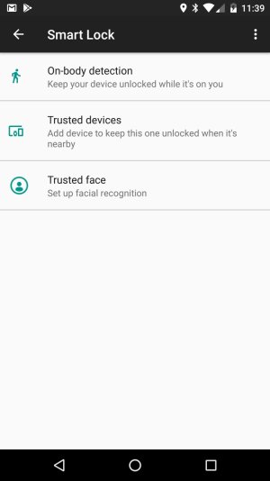

I have a Google (Motorola) Nexus 6 phone.
The Smart Lock - location feature used to work great. The phone would not lock at home and work. But it quit working sometime recently (the last 1-3 months).

Regarding the Smart Lock location feature...... I no longer even see the option for setting a location on the phone.
I've done a factory reset and the location option for Smart Lock still doesn't show up.
Did an update stop these features from working? Any suggestions on things to try?
