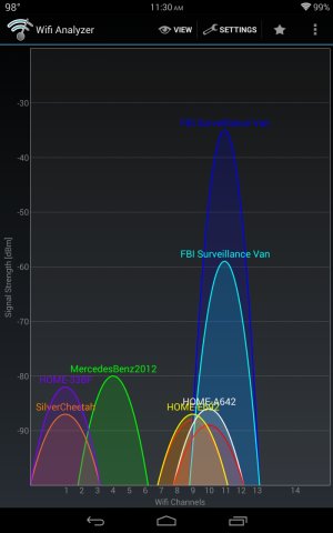

In advanced wifi settings try changing "wifi frequency band" to "2.4GHz only" and see if that helps. My N5 and N7 both seem to reconnect faster with that setting. In the play store download "wifi analyzer" to your devices and see what kind of signal strength they see from your router and also what channel your neighbors are on. You probably need to reconfigure your router settings.
Agree with wantabe. If your router is using a wi-fi channel that's pretty congested, you may find some difficulties with connection or performance. You can go into the router's settings (using your computer browser--see the router manual) to change the wi-fi channel if necessary. Also, have you tried rebooting your router? Unplug the power, wait for 10 seconds, then plug back in.
