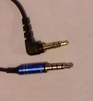

Are you certain the headset plug is fully inserted? The Nexus 4 jack has a very distinctive "click" when you reach the bottom of the jack.
Also, note the image below:
The plug at the bottom is from a headset with built-in mic and control buttons. The one at the top is a simple stereo headset. Personally, I am very suspicious as to whether the N4 can properly handle a simple (without mic) headset due to the different plug configuration.
