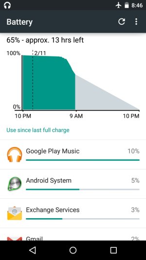

I have a Nexus 5, and whenever I listen to music with Google Play Music, it drains the battery like crazy. I have the phone in airplane mode, and location, WiFi, everything else is off. As you can see from the screenshots, the phone went down about 35% in an hour with Google Play Music at the top of the usage list. It seems to be keeping the phone awake (not sure if this is normal), and the screen was off for most of the time. What's weird is that even though I had WiFi disabled, it was showing as active in the screenshot.
Also, the phone gets VERY warm when I listen to it for a little while.
Any help would be greatly appreciated!
But only consuming 10% of the total battery consumption, or 3.5% of the battery.
It wasn't awake much until about 8AM, then it was awake solidly for a few hours - I assume that's when you were listening. The phone can't play music if the CPU is asleep.
You probably have it set to check for wifi signals, and it's doing it in little bursts that are too close together to show up separately in that line.

Until 5:30am I was sleeping so the phone barely went down - when I woke up you can see me check my phone and the battery drain a bit, but once I got on the flight at 7am, turned on airplane mode, turned off WiFi and all of that, and started listening to music, that's when it does that big drop. That was about an hour and a half and it went from about 95% to 65%. That's with the screen totally off (except for turning it on a couple of times to change the track, but the you can see the little blips at the bottom to see when I turned on the screen) so it just boggles me as to why it's using so much battery.
