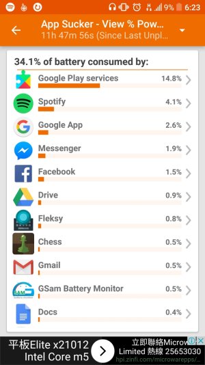

Recently, I've noticed that 'Google Play Services' is draining a large percentage of my HTC 10's battery, and consistently is the app at the top of the battery drain charts (both in Gsam and in Settings -> Power, see image below). This has been happening for over a week consistently, but I don't remember it happening when I first purchased the phone a few weeks ago. Also, this seems to be happening while the phone is in standby, and I don't think doze is kicking in since I am moving the phone all the time.
Although I am still getting pretty good battery life, I think that this could definitely be improved - is this issue normal or a problem with my phone?
