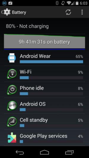

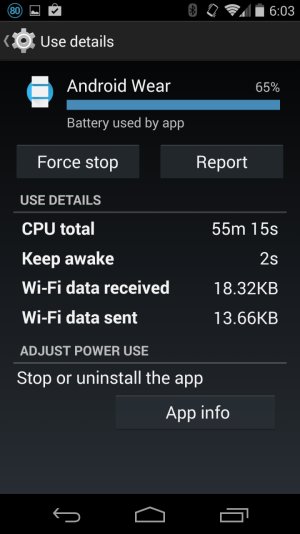

Here is a perfect example of what I mean. Today I demoed the watch to two people. I did almost nothing else the entire day. I had no notification at all. It doesn't matter what Wear apps are installed, the result is the same. I even factory reset the watch last night and reinstalled Wear on the phone (Nexus 5).
Almost 10 hours off the charger. I made no calls. I had no texts. I didn't even wake the phone AT ALL.20% of my phone battery disappeared and 65% of it was ANDROID WEAR! 55m and 15s of CPU usage on WEAR???!!!?!?!! Why???? What could possibly justify that much power?
(Oh, and the watch only used 25% of its charge during the same period)
