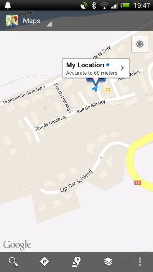

Assisted GPS? As in, how it is listed in Sense, Google Location service? I thought that was aGPS. GPS without GPS satellites is what I meant, whatever it is called. When I flash CM, I use Tasker to leave actual GPS off unless in Maps/Nav, to avoid the Maps battery drain CM10 sometimes sees. Whatever the non-GPS locations service is called, it works fine for local search and even bringing up a map of the general area, but the accuracy is usually around 1km. Was just asking what the accuracy of his Maps was reporting to see if he is EVER getting GPS signal. Perhaps it is not working in Maps either, and it just looked like it was.
Loraque, this is the accuracy from Maps as attached
Sent from my HTC One X using Android Central Forums

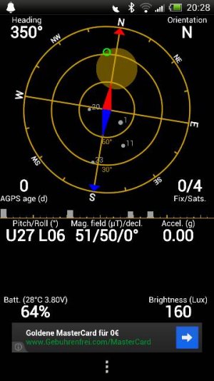

Icebike,loraque, tested the gps status app and I don't really get what it does or is supposed to do. I'm no expert I guess. But her's the result after 10 mins running of the app, not moving, outside on the same spot. If you know what it means or if it means anything,pls do explain. Tks a bunch

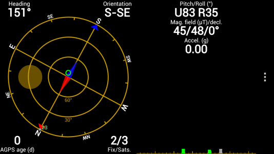

And another test
It looks to me that it is seeing satellites (the little bar graph items on the horizontal hash line), but its not getting a fix on them.
They turn green when they are used for a fix.
GPS Status does not declare it a fix until it has at least three sats, although it will show you a position well before that.
Longitude and Latitude will show up, and a error figure will show, (Where AGPS shows on the image above).
While calculating a fix the GPS symbol in the notification bar flashes. Even if it is showing you Long/Lat, with no fix the GPS chip is still listening.
Your second image shows 4 satellites, and the "radar plot" shows that some of them are directly overhead. So this should be getting a fix, but
we don't know the accuracy of the AGPS data sent from the towers, (or even if the towers in that area broadcast AGPS data)
AGPS tells the phone: here is your rough location, and here is the current Almanac (list of satellites).
With this the GPS chip can calculate which satellites it should listen to, and time to first fix can be mere seconds.
WITHOUT AGPS, the first fix can be up to 12.5 minutes, because it has to download the Almanac directly from the Satellites and that can take a while.

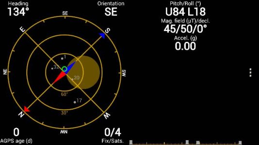

For your info, all tests were done outside. I made another one while driving and I'll attach a pic here.
I believe I had up to 5 Sats at one moment, but never a fix as you explained. I drove for about 45 mins and never ever was the GPS icon in the notification bar coming to steady.

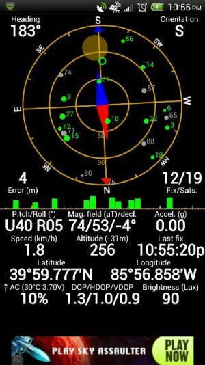

I don't want to be the bearer of bad news, but there is definitely something wrong with your GPS if you aren't getting a fix on even 1 satellite after 45 minutes. I use both a Garmin Oregon 450 and Delorme PN-60 for hiking and geocaching and accuracy requires a fix on at least 5 sattelites since we don't have the luxury of aGPS.
Your GPS Status screen should look like this....screen shot was taken after 15 seconds and was done indoors under partly cloudy sky.
