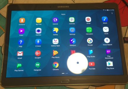

I just got a look like new Galaxy Tab S 10.5, 32gb, for only $160, the battery icon showed a few seconds then off. I know exactly what is causing it.
After 10 minutes of rework on the battery connector, problem solved. This is a different Samsung tablet but similar problem with identical connector.

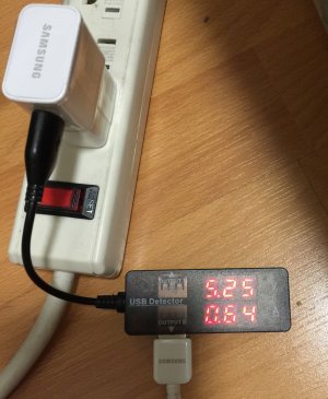

You need the tool I mention, it will tell if your tablet is charging or not by the charging current, around 1.7 Amps
USB Power Charger Current Voltage Detector Tester Monitor Meter for Phone Tablet | eBay
It doesn't matter on or off, when plugged in it should be charged, especially when on because the tablet is consuming power.
There is no guessing with this tool. Like this one, a part is not working, current is only 0.64 Amp
I will swap part one by one until I get normal 1.7 Amp, that the way repair techs do to find problem.
With all working parts available, I will find the source of problem within 10 minutes.
This Note is sold as dead but I bring it to life after working on it in 15 minutes. Your problem is not serious. it can be fixed easily.
