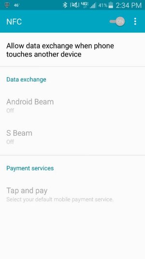

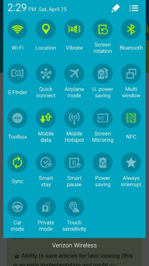

Yes, the NFC is enabled. Here's a screenshot of the pull down menu and NFC settings page. Notice that the NFC setting appears on but is not green, as all other settings are when activated. Any suggestions would be great!

I intended to say rhat the card is an NFC enabled card. My mistake.
That makes me think the SIM or phone is defective. I have a Verizon S5 w/ NFC-enabled SIM and have had no problems in usage. But your description sounds like friends who have found out their SIM wasn't NFC enabled like they thought.
