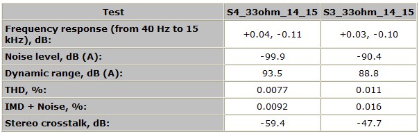

An RMAA comparison of the S4 vs S3 audio quality, performed at 33ohm headphone load and at a volume level of 14/15:
The S3 is very good (except for crosstalk) but the S4 is significantly better in the numbers with an exceptionally low noise level of -100dB.
Would you actually hear the difference? The very pickiest audiophile listener might hear a very slight difference in tone coloration due to the higher IMD+Noise of the S3.
