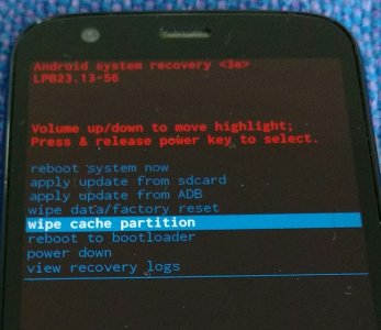

Wipe cache partition.
This is especially recommended after a system update or if you're suffering some performance or battery drain issues with your phone. In the cache partition the system keeps log files, temporary copies of apps you downloaded and some other temporary files that may be causing some problems.
The instructions to wipe the cache partition are specific for your device and they involve the use of your physical buttons to boot into recovery mode. Depending on your phone the process can be completed in seconds or could take up to ten minutes. Browse in these forums or in your manufacturer/carrier page about the specific details.
This process is completely different from clearing your apps cache, so if you're trying to free space in your phone it won't help.
[WARN]
- Some options in the Recovery menu can wipe all your data. Make sure to select the right option.
- Some phone manufacturers strongly recommend to wipe the cache partition while the phone is unplugged. Make sure you have well over 50% of battery left before you start.[/WARN]
Update. The cache partition has been removed in devices that include the new seamless updates.

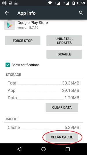

Just one app.
To clear the cache for an app go to:
settings > apps > select that particular app > tap on clear cache.
This can be one of the first things to try if an app is giving you a hard time. Just remember, some of the apps that came pre installed in your phone will be only found in the "all" tab.
Some apps can create big cache files (browsers, apps heavy on media files, ...). The size of these files will depend on your use and mostly they store data downloaded from the web (web page copies, thumbnails, etc). Most of these apps include in their own settings the option to clear the cache and I always prefer using it instead of the system settings.
A few apps manage their cache in a very personal way. They create some cache files that are not included in the count computed under your general settings > apps and you can only delete them from those specific app settings or using a file explorer.

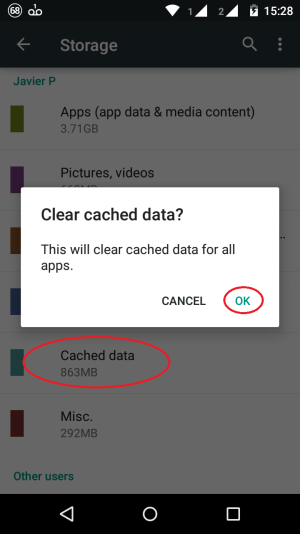

All your apps.
If you go to settings > storage and tap on cached data you will delete the cache for all your apps (well, with the few exceptions noted before). This can be handy if you urgently need some extra free storage in your phone, but t's just a temporary fix. In no time your cached data will grow back, so if you are just after free space, clearing cache won't be enough in the long term. And remember, after this process every time you open any of your apps more time and resources will be spent.
