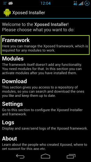

This is your first step.

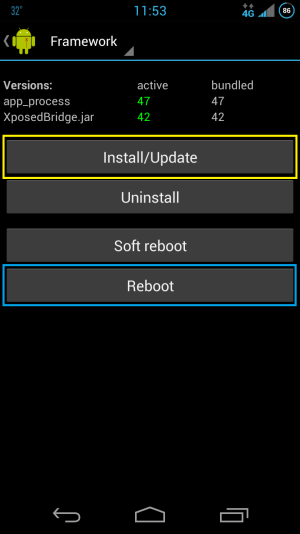

Once installed, I would suggest to open the app and tap on Framework. Even though you just installed it, you should still tap it to make sure the Framework is completely up to date.
Click install, then reboot.
Click Install/Update to ensure the main section of the app is up to date. Afterward, click reboot. Xposed Framework may prompt a reboot, you may have to click Back to the above screen, or you should be able to power down, either by selecting shut down or pressing and holding the power button.

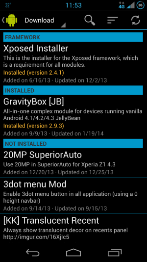

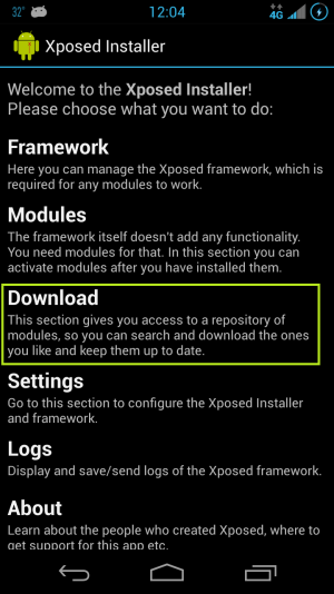

This is where downloading and installing occurs. These Downloads are what makes Xposed tick.
The download list
This is a small fraction of the Download list. It shows a small synopsis and if you click on a module, a more detailed description is brought up.
[INFO]The modules are downloaded and updated within Xposed. Since there is no auto updating, I would suggest getting in the habit of checking in from time to time to see if everything is up to date. Also, since these modules are installed via Xposed, Unknown sources needs to be checked.[/INFO]
Most of these modules are really small. Often, barely 1 MB in size. Xposed is about 1.5 MB and Gravity Box is 4.5 MB.
After the modules are installed, they are in the Modules section, which I will cover shortly, or they may be in your app drawer. Gravity Box is such a module. After installation, it appears in the drawer.

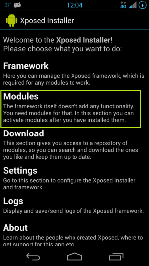

Modules is where the customizing can begin. If you thought a custom launcher or icon packs were the extent of custom on Android, prepare to be blown away.
These are screenshots from my Sprint Moto X. Not a custom ROM, but stock. Two things to immediately notice: My clock is centered, and my battery indicator is circular. Thanks to Gravity Box, I made these changes.
An updated screenshot. Notice the red icons, and moved clock.
The modular section is where the master list of installed modules is. You can access those 'apps' from this area, and launch them. This is where you would need to go if the module isn't in your app drawer.
[INFO]To reiterate, most changes may not take effect until a restart.[/INFO]

To install, simply tap on the module you would like to install, and click Download. This is where it is important to have the Unknown sources checked in Security.
When done you can click install, and it will complete.

Under frameworks my phone Shows 42 in green for xposedbridge.jar but it doesn't show a number for the app_process number when you press install\update. It just shows ---. When I reboot the 42 stays in green but the --- shows in red and doesn't update to 47 when clicking install\update. I am rooted.
Is unknown sources checked in settings?
Sent from my Nexus 5 using AC Forums mobile app
I followed instructions and able to install modules on Verizon Galaxy S5. Modules are actived within Xposed and able to launch to configure with settings, the phone is not taking any of the settings after root. Two modules tested are SwipeBack and Wanam are tested.
Did I miss something? Unable to get any module to work.
Most of the time a restart is required.
