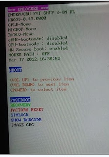

First, Power Down the phone and reboot into bootloader mode by holding down the "Volume Down" and the "Power button".
Use the volume buttons to navigate and choose " fastboot "and confirm the selection using with the power button.
Connect your HTC One X to your computer using the supplied USB cable.
4. In your computer, Run the command prompt by pressing "windows key + r" and typing "cmd Go to the folder containing the fastboot. (E.i if fastboot is in the folder C: \ android type cd \ Android
cd \ Android)
Type the following command: "fastboot erase cache
Choose reboot in fastboot menu and press the power button.

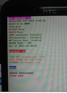

Power Down the HTC One X completely. Hold down the power button and the volume down button.
Plug the device into your computer. Then go to the bootloader mode. You will then see a “FASTBOOT USB”, as shown below.
Now it’s time to flash the boot.img. Type the following:
Windows:
fastboot flash boot boot.img
Then Reboot:reboot
Mac/Linux:
./fastboot flash boot /path/to/boot.img (~/boot.img if the file is in your home directory)
Then reboot the device by typing the following command:./fastboot reboWait until the device completely reboot and past the HTC bootscreen and enjoy.
cd \ Android)
Windows:
Then Reboot:reboot
Mac/Linux:
