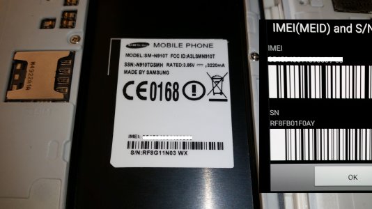

@ post #50 on page2 a pic is posted of the frame sticker that states "Mobile Phone"....
this sticker it is very similar to a N4 I recently acquired.
This frame sticker on recent purchase N4 immediately threw a red flag.
I have owned a number of N4's and as far as I can tell the phone hardware is 100%.
CPU-z, *#0*# & "about phone" have identical specs when compared to my existing legit N4.
So the only thing that is puzzling is a weird frame sticker and the S/N's do not match.
Other small accessory differences:
1. The S-pen has a non-removable tip and is not quite as responsive.
2. rear door has a leathery look but not the same feel.
3. battery is non-NFC (a NFC equipped battery allows NFC function)

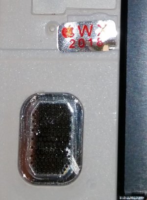

4. Odd "apple" 2018 WX decal, also has no water damage button sticker.
Does this look like a correct authentic frame sticker?
Can anyone shed some experience if this is counterfeit or legit?
