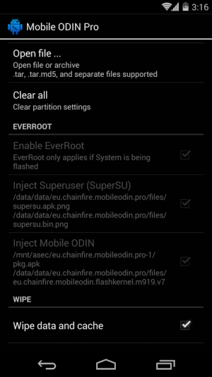

How to use Mobile Odin:
First step you need to complete after installing the app, is grant Superuser access to the app. It will download some necessary files so make sure you are on WiFi, otherwise it will use up your mobile data.
Once it is done downloading, it will give you some instructions to follow in case your phone boots into download mode. Select OK.
Next step is to scroll down to "Open file..." Depending on where you downloaded the firmware, you will select the directory internal or external SD card.
It should be one of the first files listed...select the file and then tap OK. Before flashing, make sure "EverRoot" is disabled as it may cause issues.
Now scroll down to the "Wipe..." section and select both data/cache and dalvik cache.
Finally, you will want to go back down to "Flash firmware" to begin the unrooting process.
