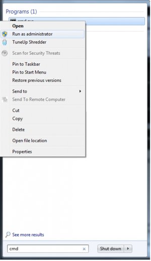

First off, you'll need to go to the start menu on the bottom left of your computer screen
Click on that and there will be a search bar. Type in the word "cmd" and hit enter
You should see something named "cmd. exe" under a list of programs
Right click that and hit "Run as Administrator" as is shown below
This will open a command windows that will allow you to do a plethora of things, but most importantly, fix our SD card :)

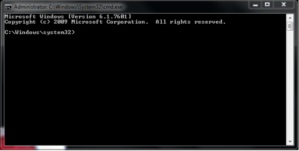

The window will look something like this:

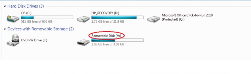

Now go back to the start menu and open "My Computer." There will be a list labeled "Devices with removable storage" under which you will find your SD card and the drive letter. You'll need the letter for when we use the chkdsk command.
In my case, the SD card has the driver letter "H:"
Your letter may be different, so make sure that you type in your specific one.

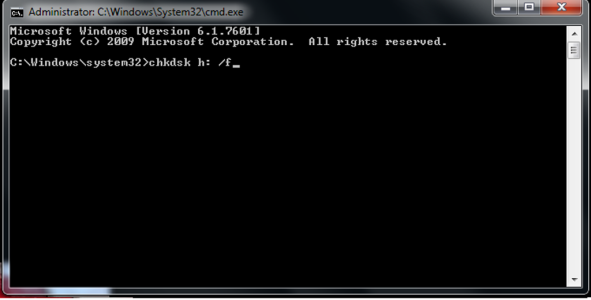

Now you will go back to the command window and type in "chkdsk" then your card's drive letter, followed by a colon and /f
It should now look something like this:
After this is typed in, hit enter and wait for the program to go to work and find then fix any corruption on the card. This can take a few minutes, depending on the amount of corruption and on the storage size of the card

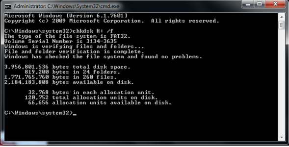

When it is done, you should see this in your command window:
In this example I have no corruption, so the wait time was very short and I didn't get any reports of data being retrieved or fixed.
Cards with corrupted data will get any recovered data stored in the directory lost.dir in the SD card's list of folders

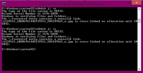

I too have the dreaded "cannot open volume for direct access"
I have used 4 SD card adapter and a micro SD reader. Same thing.
And yes the lock is up. I super glue a couple up.
Are you trying to recover data from the card or just get it working again?
