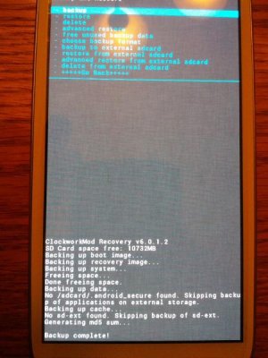

Help, please!
I went through all the steps in the OP, and was in CWM tying to load Bean's ROM from the external SD, and I got a message in CWM saying "can't mount /external_sd/". I suppose I should have put it on the internal memory. Next, following the advice to reboot if the system is misbehaving, I clicked "reboot system now"... hoping for the external sd to mount properly, or to be able to browse my files on my computer and move the ROM to the internal memory. Now my phone started booting and is stuck on the "Samsung Galaxy S3" graphic. Was it a no-no to reboot after wiping caches and formatting /system? Ideas on what to do next (already poured a glass of scotch)?
Thanks to anyone who can help out!
edit: after a battery pull, the power button just got me back to the frozen Galaxy S3 graphic, but vol up+home+power got me back into CWM. The external sd still won't mount, though, so I'm still trying to figure out what to do next. Find the nandroid backup and restore that,perhaps, if no one has a suggestion of how to get to the Bean's zip
edit #2 - restored nandroid backup in CWM. will move the ROM file to internal memory and try again

hmm weird must be an issue I am having....I think maybe it has to do with backups...do back ups (nandroid) get saved as zip files in CWM? I often make a nandroid then copy it to my ext sd card as well as my laptop for extra safekeeping but I notice the file is not a zip file.
I also wonder if it has to do with this:
Ever since I took out my sd card and stuck it in the sd reader and transferred files to my laptop I get some sort of line that mentions no sd-ext found. It never stops me from flashing roms or anything but not sure what this is all about. Or if this is unrelated could you tell me why it does this?
It is CWM. I have had issues with CWM 6+ with flashing files from an SD Card. Flash TWRP and it should work.
