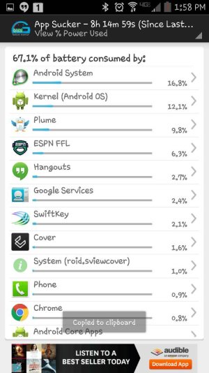

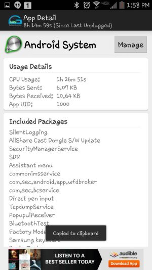

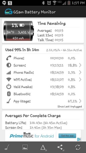

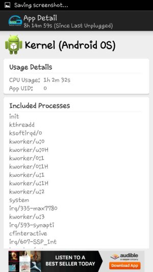

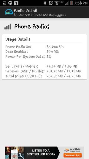

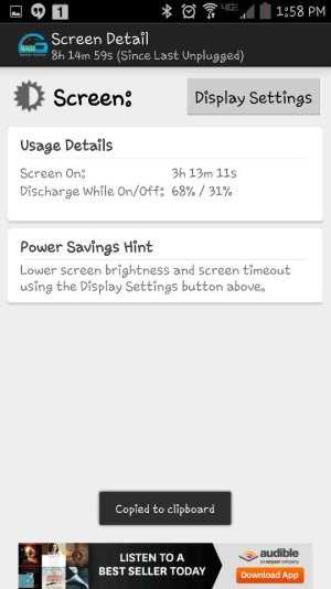

Only getting 8 hours of battery life? Screen brightness all the way down.
Used to get much more than this back when I first got it last year.
Thoughts?
