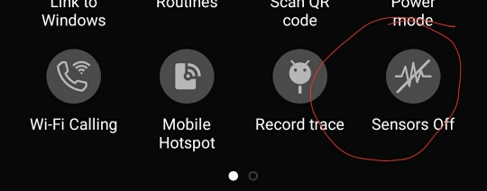

Try Disable Sensors in developer option, then highlight the Sensor icon from the pull down.

If you enable developer options, you should find the icon circled.
