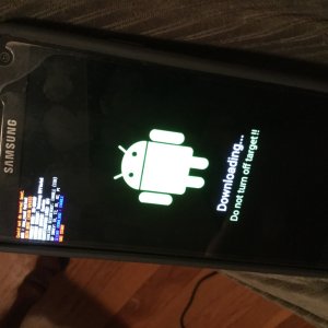

Has anyone seen the following with Galaxy Note 4
rmholler
Dec 6, 2016
4
IMG_0094.jpgIMG_0094.jpgScreen that has the android and says downloading do not turn off target
That's download mode usually accessed by pressing power+home+volume down buttons at the same time. It's typically only used with the Odin program to flash firmware to the phone. To get out of it pull the battery for a bit (then put it back in and power back up).

That combination of buttons wouldn't do anything and then I had to take out the battery and replace to boot back up
Had a chance to get a closer look at your attached pictures which show:
Could not do normal boot.
ddi: mmc_read failed
That's typically an indication the phone's internal storage is failing, which could also explain the phone freezing and rebooting on you and possibly also why you're having trouble getting into recovery (to wipe the cache partition). In reading numerous threads at XDA looks like re-flashing the firmware (via Odin) may help although temporarily (many reported the error returned and/or at some point the phone just stopped working all together). The only permanent solution seems to be either replacing the motherboard or the entire phone.
You need to make sure the last button you press and hold is the "power" button. You may have done that, but there's no way of telling from your post.
There has been success with reflashing the phone even with it showing mmc_failed error. People have done it... like in this XDA thread... see post #37. The post refers to a T-Mobile device, and since you didn't state what carrier/model you have, this post may not apply to you. Even so, it may still be possible if you can find the correct firmware, and perhaps the correct modem file for your phone. If you're on AT&T, then it might be tougher to find firmware as AT&T doesn't release it like the other carriers... still, someone on XDA might have uploaded it. You will have to search XDA.
The key to success is apparently not giving up, and also pulling the battery, holding the power button to cause a full discharge of the phone, reinserting the battery, and flashing with an older version of Odin.
In any case, read through the link (and thread) and search out similar cases for your carrier/model phone on XDA. I personally would spend a considerable amount of time doing research before replacing the motherboard or the phone. Successes like the link above points to the mmc_failed error as not always being a hardware problem.
