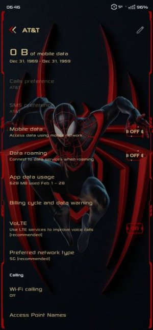

I also have an unlocked S23U on AT&T and I don't think there is a setting you can toggle anymore. I was able to turn on WiFi calling and from what I've read, I'd you're able to do that, you have HD calling as well. I can't find any setting. I was trying to find it for the opposite reason. I wanted to make sure I had the option on my unlocked device. I was also trying to find the setting on my S21U and couldn't find it on that either. I want to say the option is gone in newer software updates but perhaps it's because I had taken the SIM out already?
Sent from my SM-S918U1 using Tapatalk
AT&T S23 Ultra Carrier with unlocked Firmware , As you see it's hidden i activated.
Can change Mobile Network and turn HD Voice off.
