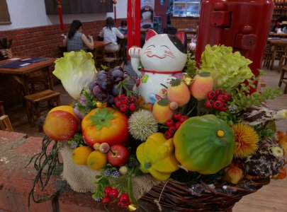

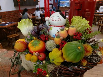

(The first shot was shot with HDR+ off while the second was shot with it on)
HDR+ does take multiple shots too, but each shot is shot with the same exposure and does not utilize bracketing, meaning that there is much less risk of "ghosting" due to movement and because the multiple exposures are similar, the darker spots can be brightened without adding noise.

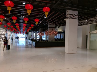

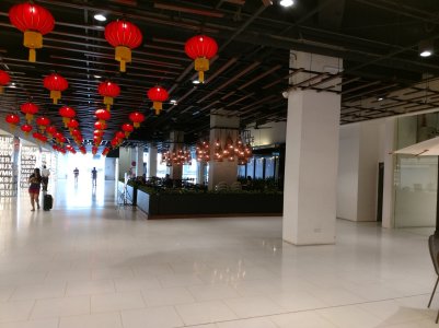

(First shot was with HDR+ off, the second with it on)
In low-light, instead of using bracketing, HDR+ takes multiple shots of a shorter exposure than what a camera would use without HDR+ and uses computational photography to enhance the image by using the sharpest image as the base layer and then replacing each pixel in the resulting image with the average color at that pixel across all photos shot by HDR+ in that moment. The result is much less noise and a more balanced image.

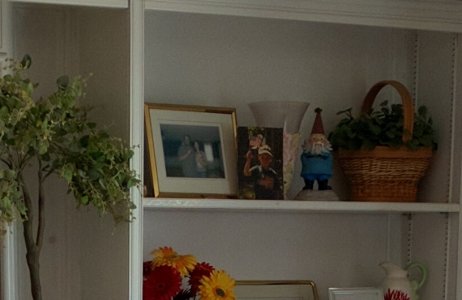

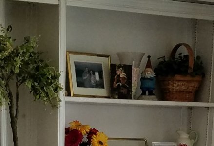

HDR+ does things differently, it uses information obtained from those multiple exposures to clear up noise. The end result can often be seen as 'soft', but what you see is what you shot. Here is an example... two 100 crops from the Nexus 6P and the Samsung Galaxy S7, both using their stock app's HDR modes.
First, the S7
Then the 6P
