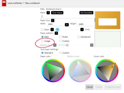

LectureNotes lets me use an image of those forms as the background image on different notebooks. Now, I'm writing on the same form just in digital format.

I use Lecturenotes the same way. I use it a lot for my genealogy research, so I downloaded a family group sheet and use that as a background image in Lecturenotes. Then it's just like writing on a "proper" form. It's a very versatile app. All it's lacking is the ability to sync.

When you create a new notebook, you can import an image as the page 'pattern'. I'm not sure what file formats it supports. I think I used a jpg.
