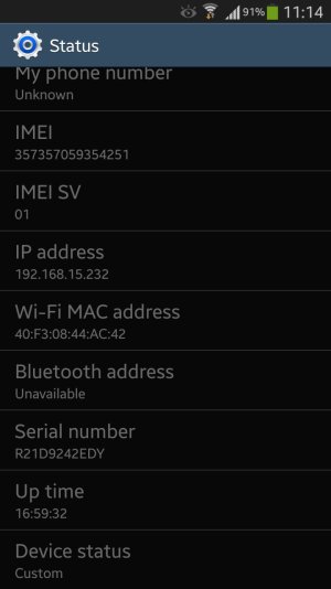

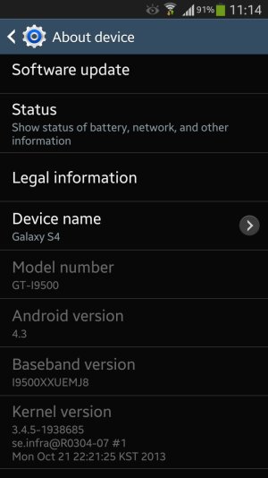

Thank you for all your suggestions guys. I have never rooted any of my android phones.. so i have no clue how to unroot either or what the triangle method is. I just started reading about it. I'm a just your average stock user. So, I'm posting screen shots of my phone for you all to see so you can spot anything unusal. The phone however is working just fine without any issues. I ran a antivirus check using Mcafee and that turned out fine as well.Screenshot_2014-01-29-11-14-20.jpgScreenshot_2014-01-29-11-14-47.jpg
Thank you for all your suggestions guys. I have never rooted any of my android phones.. so i have no clue how to unroot either or what the triangle method is. I just started reading about it. I'm a just your average stock user. So, I'm posting screen shots of my phone for you all to see so you can spot anything unusal. The phone however is working just fine without any issues. I ran a antivirus check using Mcafee and that turned out fine as well.View attachment 103189View attachment 103188
Hmm, you're on 4.3; so there's no way to reset the flash counter and get back to "Samsung official" status instead of the "Custom." I'd try flashing the stock firmware with Odin.
