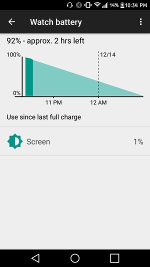

I have a first generation moto 360 I shut everything down ambient mode gesture vs. I delete my app. I reset it to factory settings 3 times but Still. Battery ends in 1 hour
Might be time to replace the battery... But before you do, make sure that the watch IS connected to the phone (when it's not, actively looking for a phone drains battery like crazy). Also uninstall/re-install Android Wear on your phone (sometimes updates to Android Wear make the watch go nuts; that solved my latest battery drain a few weeks ago).
If that doesn't help, then reset your watch and don't pair it to your phone. Just leave it out of the cradle. If in that 'blank' mode the battery doesn't last more than a few hours, then yeah, the battery needs replacement.
Thank you for the answer but My device is 4 months old. No guarantee my phone is lg g3 also i try the blank mode its ok. I think my problem is software i don't know why its really sad because i like the watch
So, when the watch is not paired and just taken off the charger, does it last a long time? It's only when you pair with Android Wear?
Mmm... that sounds about right then. Well, when you first pair it it does drain battery like crazy, and for the first few days it won't last a full day, but it should eventually go 'back to normal' within a few days.
It should, but if within a couple of days from pairing you don't get at least 10 hours of moderate use, there's something wrong with the watch...
