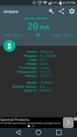

Every charger i tried gives the same result, but all of them were not Originals because i cant find one ! The charger i m using right now is Nokia's and its a very good charger, charges my battery from 10% to 100% in 1 hr 10 mins so i think its a good one.
here is a screenshot from that app you suggested, what do you say of it ?

Looks like your Nokia charger is even stronger than the original. Mine only shows 20 mA
Those two screenshots are rather sad (no disrespect intended). If I get anything under than 1500+ showing in Amphere, I throw out either the charger and/or cable.
In Amphere, the LG G3 must be set to "Old Measurement Method" (under Settings [gear icon], then Basic Settings) to get a meaningful measure.
