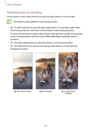

User manual pages 103 & 104. Hope this helps you out. On page 104 there is an option there ULTRA WIDE SHAPE CORRECTION you can turn on.

0.5 is using the wide angle lens and is effectively 1/2 the zoom of the "normal" lens
1 is using the "normal" 1x lens
2 is using the 2x zoom lens
Hope this helps.
Hope this helps.
To clarify what "normal" is. A "normal" zoom means that it closely matches the human eye and the range runs from 40-70mm equivalency.
Wide angle is anything less that 40mm equivalency and telephoto is anything greater than 70mm equivalency.
I used the term, "equivalency" because most equivalency measurements are based on a 35mm film/sensor size.
Just a side not, if you have taken photos with the wide angle lens and don't like the distortion there is also an option to fix it afterwards in the native photo editor. For me personally, I mostly like the distortion effect so I keep the Ultra Wide Shape Correction turned off and for photos that I don't like it on I just fix it in post.
