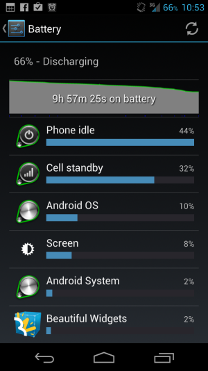

Oh no.. not another one of these threads.. I know.. everyone wants more battery life. I'm wondering if it is my phone, kernal, rom or what.. I've tried a few combinations.. I use Badass Battery Monitor and I bought Better Battery Stats.. I wanted to post my battery specs and let me know what you guys think.

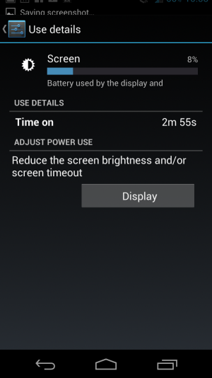

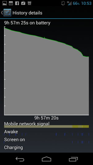

I'm running AOKP, Franco 180..regular battery. Now 65% at 12 hours seems pretty good, but this is when I was sleeping! I slept like for 10 hours this night because I was re cooperating from vegas.. Total on screen time is only 5 minutes, and I made no phone calls.. I'm on the regular battery (my extended one was lost :( ) I'm seeing people get almost 24 hours with hours of on screen time..
The one app that is appearing in your BetterBatteryStats seems to waking your kernel a lot and that would be my best guess as to why your battery is draining quick.
That's definitely bad stats. You should be getting 1.5 to 3 hours of screen time, depending on what you're doing with the phone. The first thing I'd do is a battery pull. Sometimes you get a runaway app, and that's the most certain way to reset everything. If that doesn't help, you probably have some app on there that's a POS. People seem to install the stupidest things...usually just because they exist. I'd delete every app that you aren't truly and actively using. You can always re-download them later.
I do have a ton of apps, the app that I see that uses the most battery is BeyondPod, and that is one of my most used apps.
Just wanted to give you guys an update... I've used tons of different roms and kernals... It's just as bad as before, and my phone is sleeping pretty well!!
EDIT: 4G, GPS, SYNC, BLUETOOTH, WIFI are all off.
weak phone signal could be draining your battery, wifi may help. But I also struggle with similar problems, crappy battery. LightFlow and Google Maps wake my device all day
My phone never seems to really get a "good" signal.. I don't have it when often my girlfriend on ATT (iphone) has it... and I'm on supposedly the most robust network in America. You think it could be just a lemon phone? I have insurance on it... Can I do anything?
