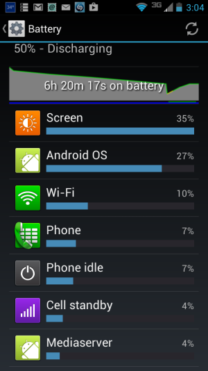

What the what? My Droid is giving me like 90 minutes of use. (oh, I just said that).
I have the screen on low, the GPS notifications off, the pinging apps for only when they are open.
The only thing I can think is, I am in a very marginal reception area. Can that create this kind of strain?
This is ridiculous, I have to move from charger to charger. Hep! Hep!
This said six hours when I took the shot...I was out in like two hours, with little use.
Weak signal can definitely do that.
It would help to see more data. Charge up to 100%, then let it drain to 20-30% with normal usage, without charging in between. Then show us:
1. The main Settings>Battery screen.
2. The fullscreen battery graph screen (which shows Awake time and Cell Signal Strength).
3. The Screen category (to see total Screen On time).
4. The Cell Standby category, if present (to see Time Without Signal).

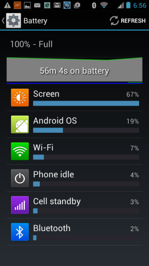

Okay, I'll get that, but here is a ridiculous screen I just grabbed...56 mins estimated for a full charge!
Some said the battery paks can "degrade"? Can I get that fixed??
No, that means how long the phone has been operating on battery since the last full charge.
