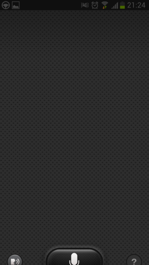

I have the Samsung Galaxy S3 which is only 2 months old. I noticed this evening that the screen kept flashing on and off by its self, even though i wasn't touching it and it wasn't plugged into anything. After staring at the screen for a while to see what the hell was going on, it appears that a few apps have a mind of their own and decide they want to open up.
Firstly the S Voice (I think that's what its called, Same as Apples Siri), just kept flashing up, and then closing again constantly. (Screen shot attached)

Next time try taking the battery out for 10 seconds and see if that helps. That does a soft reset.
You could try clearing your cache by booting into recovery.
To do so turn your phone off, and pull out the battery for 3 seconds then put it back in and put the case on.
To boot into recovery hold down "Volume up + Home button + Power button". Hold all three until you see samsung pop up on the screen, then let go.
When it boots use your volume keys to scroll down to "Wipe Cache" and press the power key. When it finishes scroll back up to "reboot device" and press power key. Your device will reboot and hopefully the problem will be fixed.
If that doesn't help, I would back up all the your info and do a factory reset through the settings menu. It's located in the section titled "Back up and reset".
