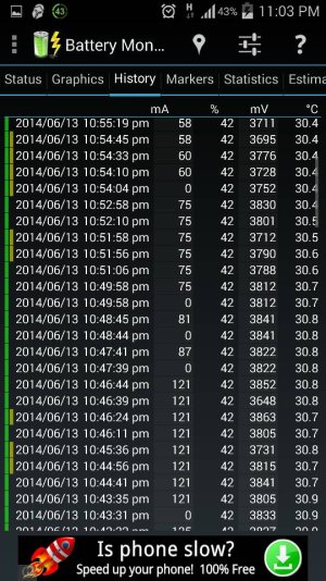

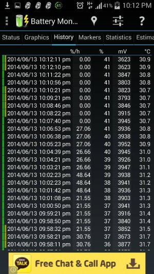

Here are the results
Sent from my GT-I9500 using AC Forums mobile app

The %/h even got to negative while i was posting the screenshots with my phone.
Can you tap on the %h and retake the screen shot? It should give you "ma" similar to my screen shot

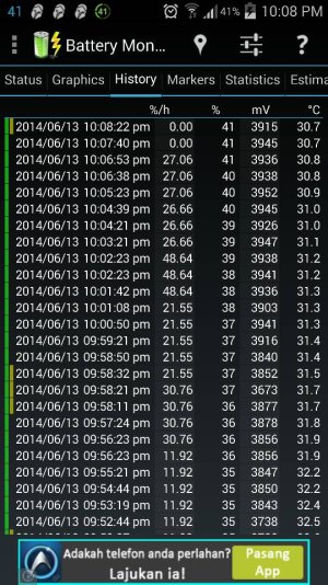

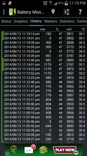

Certainly slow charging rate. I would suggest trying another quality charging cable and charger.

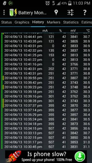

Newest shot , there was a sudden increase then decreasing in the milli ampere

Do you think this could also be caused by battery problems or are you sure that it's the cable and charger problems? I think it can't be the charger's problem since when I use the cable with my powerbank, it's the same situation. So the cable?
Something else to test is to let it monitor when not charging and see what battery consumption is.
Your charging rate seems odd.
Also I would clean the charging contacts. Use a toothbrush and rubbing alcohol.
dpham00, Android Central Moderator
Sent from my Verizon Samsung Galaxy Note 3

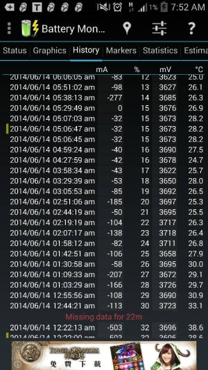

Here's the discharging rate without any interference
