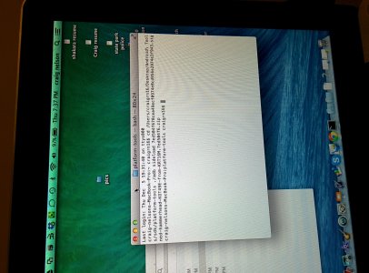

platform tools usually. I'll take a pic and put it up so you can see what I am getting when I put in the commands

View attachment 95416This is what keeps coming up
ok u typed cd [path] ./adb sideload all at the same time..
as per the screenshot u r on "platform-tools" on the terminal which is good.
before U DO THIS MAKE SURE THE DEVICE IS CONNECTED TO MAC AND THE PHONE IS IN FASTBOOT MODE
now do this type (or copy paste) below to terminal
./adb sideload [filename].zip
and then HIT ENTER

Ok judging from the screen shot what did I do wrong?
