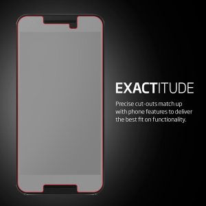

OK, I know you've said it doesn't cover any of the sensors but is the cutout in the protector for the top speaker grille an inverted L? The proximity sensor along with the lux sensor are directly below the right hand side of the top speaker grill and need to be uncovered (about 4mm x 6mm needs to be uncovered). If the tempered glass covers it the proximity sensor will not work. There is no impact on the lux sensor. Even if the protector has a suitably sized cutout and is slightly wrongly placed it's going to be wonky.
Edit - added a pic to show a protector brand with the correct cutout - this particular brand's initial batch for the 5x did not have the correct cutout.
No mine is not like the image. I should get that one and try it. With the glass being clear why is the sensor being prohibited from working?
Thank you for your help!

No worries.
I think the prox sensor is IR based and tuned to avoid any IR reflectance from the screen glass from registering (or the screen glass is built to be non IR reflective). But the screen protector glass and adhesive although clear to visible light will be IR reflective so registers as something near to the prox sensor.
I went ahead and purchased the new tempered glass screen protector. That will arrive in the next day or so. Thanks for your help!
