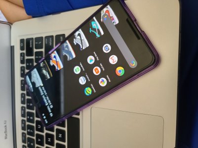

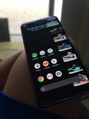

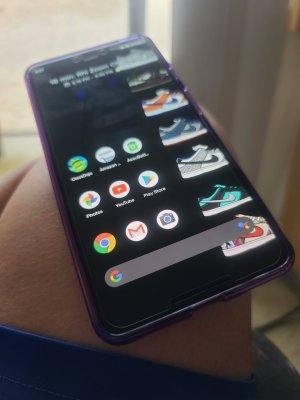

Here are just some examples of similar shots. The first set was taken by my Ultra, and you've just got to temper your expectations about what photos will look like. There will be blur around what the center of your picture is, especially the closer you get. Look how blurry that app icon is that isn't the YouTube app?! The second set was taken by my Pixel 3XL. Little to no blurring due to it being just one camera, and being a small one at that. I guess what I want to show you is that it's just how things are with Ultra photos, so if you just got it, and your main reason was camera, and you're not happy...speak now(and return) or forever hold your peace.

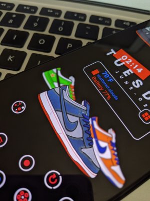

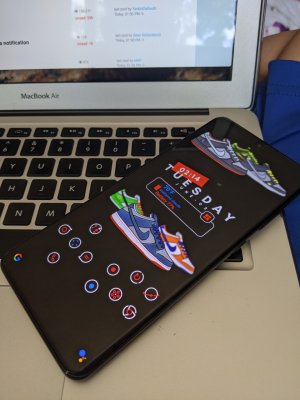

Last set of examples, I promise. These were taken with the Ultra, and the first one was just regular photo mode. It's hit or miss with indoor lighting, and I swear I tapped the screen to focus on the YouTube icon. It still came out blurry. The second one required me diving into pro mode and playing with the settings to take the same picture. This time, the YouTube icon came out CRYSTAL CLEAR and very crisp.
I guess that just shows that the camera can take great (still) photos (in good lighting), but it requires way more work. It's def not a point and shoot.
