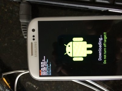

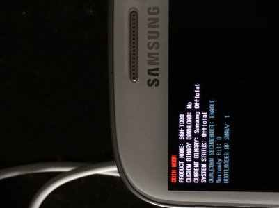

OK SO I'M IN A BIT OF A BIND!!! SOMEONE HELP!!!!
My T-mobile S3 has been stuck on the last Samsung pulsing screen for the last few days. It does not boot past that and when I put it in "download mode" I get the following screen. I have tried everything I have downloaded odin and I have been looking for the original os. I just want my phone back and I am willing to do it myself. I have the latest odin and samsung usb drivers installed. If anyone can point me in the right direction in terms of finding 4.1.2 or even 4.2 and also how to get my phone working again I would be forever in your debt and I will donate the first millions of my eventual millions to your children's college funds or whatever. Point being PLEASE someone help me out [inappropriate language removed by moderators]. I look forward to your help. Let me know if there is any other information you need.
Thanks again internet friends.

Welcome to the forums!
First off, your phone already has the 4.3 bootloader with Knox (evidence is in the Download mode pictures that you posted) so you can't go back to older firmware. You'll have to use the current 4.3 firmware which you can find http://samsung-updates.com/details/25180/Galaxy_S_3_T-Mobile/SGH-T999/TMB/T999UVUENC2.html here.
It appears that you're already familiar with Odin so I won't bother with that information.
Assuming that everything goes ok and the boots normally, you should boot into Recovery mode and make sure that's operating correctly and also clear the system cache while you're there - then proceeded with the normal phone setup.
