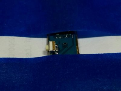

My power switch crapped out a few weeks ago. My phone was about 2years old. It was randomly rebooting. How I figured it out was when I would take the battery out, as soon as I would put it back in the phone it would vibrate and like it wanted to start w/o me pressing the power button. I replaced the switch myself and back in business. I bought 3 switches from eBay for $6.
The little white spec on the penny is the switch.

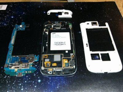

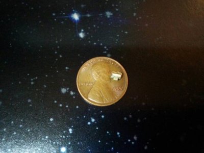

Mine would have cost $150 for TMO to replace, so I put that $150 towards a Nexus 5 and bought the $6 switches.. Definitely tiny, but doable and I have Sasquatch size hands :)
Sent from my Nexus 5 using Tapatalk
