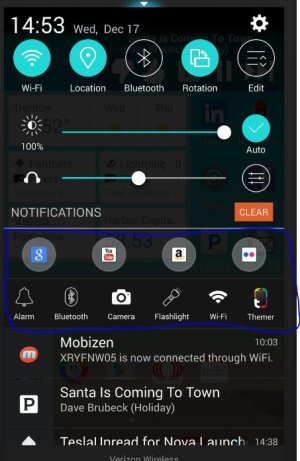

I have an Lg G3 running KitKat, rooted with Nova Launcher. When i pull down my notification bar, I have two rows of icons that I'm not sure how they got there. Pls see attached jpeg. I just would like to know how to get rid of them... Thanks
They are the two rows of icons circled in Blue....

Probably Themer. They added a very annoying toolbar that sometimes activates itself even if you don't use Themer as your active Launcher.
Just open Themer, go to Settings and turn off the Notification Toolbar.
Many Thanks, That took away the second set of icons. The first set I found was some type of speed dial installed by mercury browser. Thank you for your quick response...
Glad I could help. And yeah, I hate those toolbars too but Themer's sin was not including it (some phones don't have quick access to settings so that's a bonus), it was activating it at install or update and even without even running Themer as your launcher.
