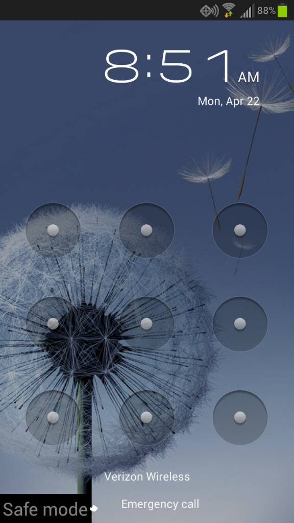

To boot into Safe mode, reboot the phone and once it finishes shutting down, press-and-hold the Volume Down rocker and keep holding it until the phone finishes booting. You'll see a screen like this
(minus the Pattern lock business, unless of course you have a Pattern lock).

To boot into Safe mode, reboot the phone and once it finishes shutting down, press-and-hold the Volume Down rocker and keep holding it until the phone finishes booting. You'll see a screen like thishttp://img.tapatalk.com/d/14/01/28/vapudahu.jpg(minus the Pattern lock business, unless of course you have a Pattern lock).

I... have no idea what you guys are saying. I just held down the volume down button for ages and nothing happens. Then I tried the same with the home button, nothing. So I held the volume down WITH the power button, and the home button with the power button, and they just booted up the phone normally. No safe mode.

Not the home button. Just hold the menu button (left of the home button)
No other buttons and hold it until it boots up
instead of holding volume down, I place my finger where the menu button should be and it does the same
Interesting - this does nothing on my Samsung Galaxy S3 (Verizon SCH-i535). What phone do you have?
