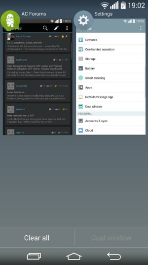

Home screen keeps redwaring itself and phone is force quitting every single app in the background im
Wikh
Jul 21, 2014
171
You can see how many apps I have running at the same time (0) and running processes. Except Facebook I have zero running processes in the background - besides of the stock processes.
I attached screenshot about my multi task and running app screen where you can see the same.
Any suggestions? Everything is closing immediately and even the home screen is redrawing itself. I don't know what could be the problem but it makes me super annoyed even though I love(d?) the phone.
Edit: Screen is redrawing even after closing the AC app after this post.

Give it a durn good Cached Data clear and a Cache Partition wipe and see whether that fixes it.

I've seen this posed on other forums. Because the QHD needs more information to be held,it uses 600mb of RAM as video RAM. HD screens only use 250-300MB. The LG bloatware is also heavy on Ram. Because of this RAM is running out and apps are being closed in the background and redrawing.
If youre rooted download Kcontrol and look and the memory use and GPU use settings. You can see the 600mb of GPU ram being used.

But that means that every time when I press the home button ~5-10 seconds waiting is normal for a flagship phone? Same for changing apps? I doubt that this should be considered normal. :(

Disable bloat and reboot you will be fine. Also clearing all running apps usually helps.
OK, heres a screenshot from my M8 of GPU memory usage. Can someone post the G3 GPU memory usage of the G3 for comparison? The app is kcontrol.
Look at the difference in your memory usage of "settings" and mine. Yours is 71mb and mine is 20somethingmb. There's definitely a higher memory usage on the G3.
What should I disable?
Any other suggestions? Thanks. :)

The redraw was really annoying to me as well and also had an issue where the wallpaper would redraw so I first disabled all the VZW bloat and that didn't help. After reading that it was probably the LG launcher, I installed Nova and have not had the horrible redraw issue since.
So I should use another launcher and apps won't close that often and home screen won't be redrawn every now and then? Hmm.
Any other suggestions? In like the stock launcher. :(

I still love my G3 - only want to figure out what could cause the problem I have? Now I'm using Nova and I didn't had the problem since then - but why do I have to do this so it won't redraw every now and then - it's a mystery for me.

Hi Wikh, can you tell me what model, carrier and software version you are on? Please clarify what you mean by your home screen redraws itself.^MA
Yay, thank you so much for the post!
I'm using a LG-D855 16gb version of the G3 - it's a European version and its carrier free. I have the latest update - v10g.
When I had apps open and closed them so I can go back to the home screen the home screen just started because it closed itself before. Its really strange and I could even understand it but I used one single app at a time and it still did the same! Clock, calendar, or the app of this forum. And as you can see I didn't had a lot of background processes in the background.
Since then I switched to Nova launcher and it seems it's not restarting (as often - at least) like the stock launcher.
But I would like to use the stock launcher without any problem as it supposed to work.
Apps are still tending to close almost immediately when I put them to the background - not 100% of them, but most of them. It can be a little bit annoying.
