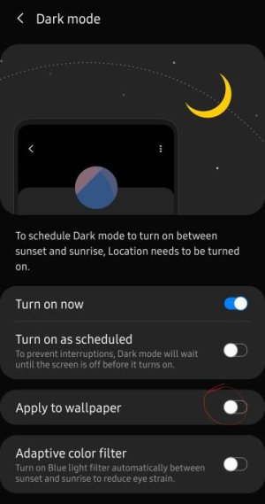

Found the fix. It's in the display settings under dark mode. Tap dark mode and click "apply to wallpaper" off.

Swipe down the top panel when youre on your home screen and click on the dark mode and click on details and then turn off "apply to wallpaper" and boom!!
