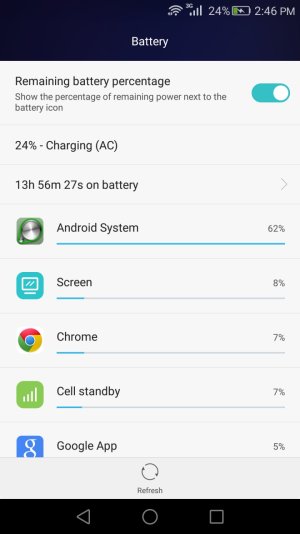

I really wanted to like this device with its beautiful design and all of its impressive features and specs but one issue has kinda ruined the entire experience for me.
I get terrible battery life specially on standby. Android System is what's eating up my juice and is often at 62% or so which I find very strange. Most Android smartphones I've used had Android System somewhere between 6% to 10% max. When I go to sleep with a 100% fully charged battery, I wake up with 65% or 70% left. That's with Wi-Fi, GPS, Bluetooth, mobile data and auto sync all turned off. I tried using the "ultra" power saving mode but to no avail. I even tried disabling some apps including most of Google's services, resetting the phone, clearing the cache but none of that helped. I sent it back to the warranty and they "reinstalled" the software or so they say but Android System is still using up more than 50% (it keeps changing but it's always above 50% or 60% and after a long time of standby during my sleep I then wake up only to find it hit 86%. Android System at 86%!!). The problem hasn't been fixed and I'm really, really frustrated mostly because I sold a perfectly functioning LG G2 for the P8.
Any help will be really appreciated.
I have not seen any problems at all with battery life with the p8. Make a factory reset.

I uninstalled Play Services, did a reboot, disabled Location History in Google Now and I'm still where I am. I've had the phone for almost two weeks now. I'm pretty sure that's enough time for it to "condition itself".
Would you suspect this is a hardware issue or is that unlikely?
