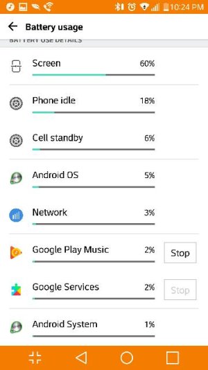

I had the same problem and thought maybe it was Google play music as I use that alot. Tried everything with no avail. Also noticed it was running hot in my pocket. Backed up and did factory data reset. When it came back up, and I restored everything back, it worked great. Battery life was amazing for about 1 week, then I noticed it running hot again and starting to drain. One battery calculation showed 4 hours remaining on a full charge! I then noticed that by default in battery settings, the battery saver was turned off. There is an option in there that "Restricts apps in background". Make sure that is turned on as well. That seemed to make a big difference. Time will tell. If that doesn't work, a good task killer app may be the only choice left. I think LG may have known they had a problem and that, in part, may have been why they offered a free spare battery and cradle.
ever since I got the extra battery case and battery... I've been swapping my battery as needed... but what I've realized since getting this swappable battery... my battery life is horrible. when i had just the one battery.. it was like 19hrs of battery.. about 5 hours of sot... now its like. 5 hrs battery and 2 to 3hrs of screen time... i don't understand why my battery life is so horrible. I'm having to swap batteries 3 or more times a day.
Just to let you know that since turning on the battery saver and restricting apps from running in the background, I am at 83% with 14 h 14 min remaining time left. I think this is the key to getting better life out of the LG G5. Kind of stupid that it isn't turned on by default. I mean, whoever wants their phone to run hot and die quick please raise your hand! :mad:
