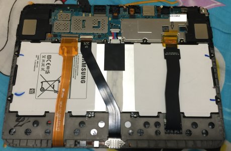

With a loose LCD cable, the display will normally look like this, most people will think the LCD is bad with pinky colors and black spots:
Discoloration or more pink than others is loose LCD cable. Open your tablet, disconnect, reconnect the LCD cable ( right side ) and secure the locking tab with tape will prevent it happen again. Make sure the white line on cable aligned with the one on main board. Don't put back the rear cover, test it by plug in your USB cable to charge, press the HOME button, the green battery icon should see on the screen in the black background. If you see the pinky icon, your LCD cable is not connected properly.

The cover has nothing to do with on or off, I have a tablet without cover used for testing, it runs fine. Check your connection without cover, secure them with tape, it should work fine, otherwise you have bad LCD cable or LCD.

Thank you for step by step guide. In my case the lcd cable was a little loose and the connectors was visible, i pulled the cable out and put it back till the connectors not visible. It works perfect now. You save my tablet. Thank you again.

Thanks this was much easier that I thought. Couple of points:
1. An old credit card or flier mileage card can work the case opening, however you will ruin the card
2. There is a latch for the cable. right above where the cable enters the connector there is a thin black bar, gently lift it up towards the battery. then after reinserting the cable push it back down to lock the cable in place.
